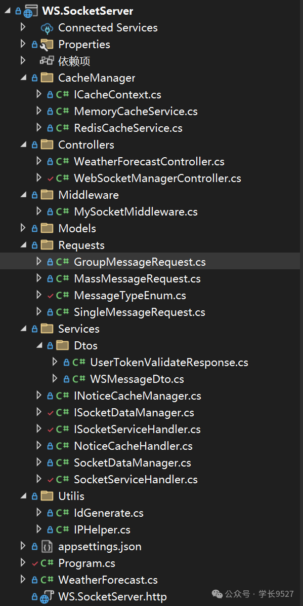

2、在Web项目中集成WebSocket
  2.1、创建WebSocket服务端项目
  2.2、引用nuget包,此处引用的是存储相关的包,WebSocket已经集成到dotnet webapi项目中。
  <ItemGroup>    <PackageReference Include="CacheManager.SystemRuntimeCaching" Version="2.0.0" />    <PackageReference Include="StackExchange.Redis" Version="2.8.31" />    <PackageReference Include="Swashbuckle.AspNetCore" Version="6.6.2" />  </ItemGroup>
2.3、修改appsettings.json配置文件
{  "Logging": {    "LogLevel": {      "Default": "Information",      "Microsoft.AspNetCore": "Warning"    }  },  "AllowedHosts": "*",  "SocketApi": {    "Server": "http://localhost:5072",    "SocketUrl": "/ws", //Socket监听地址,区分于WebAPI    "OpenNoticeRecord": "true", //开启消息记录    "HistoryNoticeCacheDay": "1", //离线消息缓存时间/天    "GroupAddress": "100001", //群组    "AiringAddress": "public", // 广播地址-所有成员可接收    "OrientAddress": "orient" //定向传播-需要双方携带接收人的账号  },   //当你消息服务是固定账号模式,则可以配置在配置文件,否则可以通过数据库来管理  "SocketAccount": [    {      "Account": "luoni",      "AccountName": "罗尼"    },    {      "Account": "kate",      "AccountName": "卡特"    }  ],  //使用群聊的格式,包括群Id,群名称以及群成员账号。  "GroupSocketAccount": [    {      "GroupID": "100001",      "GroupName": "群聊1",      "GroupUsers": "luoni,kate"    }  ],  "CacheType": "Redis", //Redis/Memory //消息存储方式,缓存离线消息。  "RedisConfig": {    "Connection": "localhost:6379",    "Db": "2"  }}
2.3.1、创建群配置模型GroupSocketAccount.cs
namespace WS.SocketServer.Models{    /// <summary>    /// 群模型    /// </summary>    public class GroupSocketAccount    {        /// <summary>        /// 群Id        /// </summary>        public string GroupID { getset; }        /// <summary>        /// 群名称        /// </summary>        public string GroupName { getset; }        /// <summary>        /// 群成员        /// </summary>        public string GroupUsers { getset; }      }}
2.4、创建消息处理相关操作类
2.4.1、创建消息处理中间件MySocketMiddleware.cs
using System.Net.WebSockets;using System.Text;namespace WS.SocketServer;/// <summary>/// WebSocket服务端处理中间件/// </summary>public class MySocketMiddleware{    private readonly RequestDelegate _next;    private readonly ISocketServiceHandler _handler;    /// <summary>    ///    /// </summary>    /// <param name="next"></param>    /// <param name="handler"></param>    public MySocketMiddleware(RequestDelegate next, ISocketServiceHandler handler)    {        _next = next;        _handler = handler;    }    /// <summary>    /// 根据状态处理    /// </summary>    /// <param name="context"></param>    /// <returns></returns>    public async Task InvokeAsync(HttpContext context)    {        if (context.WebSockets.IsWebSocketRequest)        {            var socket = await context.WebSockets.AcceptWebSocketAsync();            //创建连接对象(此对象存储在内存中)            await _handler.OnConnectedAsync(socket);                      try            {                //消息缓冲区1M(分段接收)                    var buffer = new byte[1024 * 1024 * 1];                while (socket.State == WebSocketState.Open)                {                    var result = await socket.ReceiveAsync(new ArraySegment<byte>(buffer),  CancellationToken.None);                    switch (result.MessageType)                    {                        case WebSocketMessageType.Text: //接收文本消息                            var message = Encoding.UTF8.GetString(buffer, 0, result.Count);                            await _handler.ReceiveTextAsync(socket, message);                            break;                        case WebSocketMessageType.Binary: //接收文件流                            await _handler.ReceiveFileAsync(socket, result, buffer);                            break;                        case WebSocketMessageType.Close: //关闭连接                            _ = _handler.OnDisconnectedAsync(socket);                            break;                        default:                            throw new ArgumentOutOfRangeException();                    }                }            }            catch (Exception e)            {                _ = _handler.OnDisconnectedAsync(socket);                var msg = $"处理Socket状态发生异常,Exception:{e}";                //_logger.Error($"处理Socket状态发生异常,Exception:{e}");                Console.WriteLine(msg);            }        }        else        {            await _next(context);        }    }}
2.4.2、创建Socket对象管理接口ISocketServiceHandler
using System.Net.WebSockets;namespace WS.SocketServer;/// <summary>/// WebSocket对象管理接口/// </summary>public abstract class ISocketServiceHandler{    /// <summary>    /// 连接Socket    /// </summary>    /// <param name="socket"></param>    /// <returns></returns>    public abstract Task OnConnectedAsync(WebSocket socket);    /// <summary>    /// 断开连接的Socket    /// </summary>    /// <param name="socket"></param>    public abstract Task OnDisconnectedAsync(WebSocket socket);    /// <summary>    /// 接收文本消息    /// </summary>    /// <param name="socket"></param>    /// <param name="message"></param>    /// <returns></returns>    public abstract Task ReceiveTextAsync(WebSocket socket, string message);    /// <summary>    /// 处理文件流    /// </summary>    /// <param name="socket"></param>    /// <param name="result"></param>    /// <param name="buffer"></param>    /// <returns></returns>    public abstract Task ReceiveFileAsync(WebSocket socket, WebSocketReceiveResult result,  byte[] buffer);    /// <summary>    /// 单发消息    /// </summary>    /// <param name="request"></param>    /// <returns></returns>    public abstract Task SendMessageAsync(SingleMessageRequest request);    /// <summary>    /// 群发消息    /// </summary>    /// <param name="request"></param>    /// <returns></returns>    public abstract Task SendGroupMessageAsync(GroupMessageRequest request);    /// <summary>    /// 发送全体    /// </summary>    /// <param name="request"></param>    /// <returns></returns>    public abstract Task SendMassMessageAsync(MassMessageRequest request);}
2.4.3、Socket连接对象实现类SocketServiceHandler
using Logger.Service.Interface;using System.Net.Mail;using System.Net.WebSockets;using System.Security.Principal;using System.Text;using System.Text.Encodings.Web;using System.Text.Json;using System.Text.Unicode;using WS.SocketServer.Models;using WS.SocketServer.Services.Dtos;namespace WS.SocketServer;/// <summary>/// Socket连接对象处理类/// </summary>public class SocketServiceHandler : ISocketServiceHandler{    private readonly ISocketDataManager _sockets;    private readonly ILoggerContext _logger;    private readonly INoticeCacheManager _noticeCacheManager;    private readonly IConfiguration _configuration;    /// <summary>    ///    /// </summary>    public SocketServiceHandler(ISocketDataManager sockets, ILoggerContext logger,        INoticeCacheManager noticeCacheManager,IConfiguration configuration)    {        _sockets = sockets;        _logger = logger;        _noticeCacheManager = noticeCacheManager;        _configuration = configuration;    }    /// <summary>    /// 连接Socket    /// </summary>    /// <param name="socket"></param>    /// <returns></returns>    public override async Task OnConnectedAsync(WebSocket socket)    {        try        {            var socketId = Guid.NewGuid().ToString("N");            await _sockets.AddSocket(socketId, socket);        }        catch (Exception e)        {            var logmsg = $"连接Socket异常:{e.Message}";            Console.WriteLine(logmsg);            _logger.Error(logmsg);            throw;        }    }    /// <summary>    /// 断开连接的Socket    /// </summary>    /// <param name="socket"></param>    public override async Task OnDisconnectedAsync(WebSocket socket)    {        try        {            var socketId = _sockets.GetSocketId(socket);            if (socketId != null)            {                await SendCloConnectedNoticeAsync(socket,"");                await _sockets.RemoveSocketAsync(socketId);            }        }        catch (Exception e)        {            var logmsg = $"连接关闭,清除内存中的Socket对象发生异常:{e.Message}";            Console.WriteLine(logmsg);        }    }    /// <summary>    /// 单发消息    /// </summary>    /// <param name="request"></param>    /// <returns></returns>    public override async Task SendMessageAsync(SingleMessageRequest request)    {        try        {            var connection = _sockets.GetAllConnections().Where(it => it.Key == request.SocketId)                .Select(it => new                {                    SocketId = it.Key,                    Socket = it.Value                }).FirstOrDefault();            if (connection != null)            {                if (request.MessageType != MessageTypeEnum.Files)                {                    await SendMessageAsync(connection.Socket, request.Message.ToString());                }                else                {                    await SendFileMessageAsync(connection.Socket, (Stream)request.Message);                }            }        }        catch (Exception e)        {            Console.WriteLine(e);        }    }    /// <summary>    /// 指定连接发送    /// </summary>    /// <param name="request"></param>    /// <returns></returns>    public override async Task SendGroupMessageAsync(GroupMessageRequest request)    {        try        {            var list = _sockets.GetAllConnections().Select(it => new            {                SocketId = it.Key,                Socket = it.Value            }).ToList();            if (request.SocketIds != null && request.SocketIds?.Length > 0)            {                list = list.Where(it => request.SocketIds.Contains(it.SocketId)).ToList();            }            if (list?.Count == 0)            {                throw new Exception("连接不存在");            }            if (request.MessageType != MessageTypeEnum.Files)            {                //群发文本                foreach (var connection in list)                {                    await SendMessageAsync(connection.Socket, request.Message.ToString());                }            }            else            {                //群发附件                foreach (var connection in list)                {                    await SendFileMessageAsync(connection.Socket, (Stream)request.Message);                }            }        }        catch (Exception e)        {            Console.WriteLine(e);        }    }    /// <summary>    /// 发送全部    /// </summary>    /// <param name="request"></param>    /// <returns></returns>    public override async Task SendMassMessageAsync(MassMessageRequest request)    {        try        {            //过滤发送者、发送者不需要自己发送的消息            var list = _sockets.GetAllConnections()                .Where(w => w.Key != request.FromSocketId)                .Select(it => new                {                    SocketId = it.Key,                    Socket = it.Value                }).ToList();            if (list?.Count == 0)            {                throw new Exception("连接不存在");            }            if (request.Message == null)            {                throw new Exception("消息内容为空");            }            if (request.MessageType != MessageTypeEnum.Files)            {                //群发文本                foreach (var connection in list)                {                    await SendMessageAsync(connection.Socket, request.Message.ToString());                }            }            else            {                //群发附件                foreach (var connection in list)                {                    await SendFileMessageAsync(connection.Socket, (Stream)request.Message);                }            }        }        catch (Exception e)        {            Console.WriteLine(e);        }    }    /// <summary>    /// 发送附件数据    /// </summary>    /// <param name="socket"></param>    /// <param name="stream"></param>    /// <returns></returns>    private async Task SendFileMessageAsync(WebSocket socket, Stream stream)    {        if (socket.State != WebSocketState.Open)        {            throw new Exception("连接已关闭");        }        ;        if (stream == null)        {            throw new Exception("附件数据不存在");        }        try        {            byte[] content = new byte[stream.Length];            await stream.ReadAsync(content, 0, content.Length);            stream.Seek(0SeekOrigin.Begin);            await socket.SendAsync(new ArraySegment<byte>(content), WebSocketMessageType.BinarytrueCancellationToken.None);        }        catch (Exception e)        {            Console.WriteLine(e);            throw;        }    }    /// <summary>    /// 发送文本消息    /// </summary>    /// <param name="socket"></param>    /// <param name="message"></param>    /// <returns></returns>    private async Task SendMessageAsync(WebSocket socket, string message)    {        try        {            if (socket.State != WebSocketState.Open)            {                throw new Exception("连接已关闭");            }            ;            byte[] content = Encoding.UTF8.GetBytes(message);            await socket.SendAsync(new ArraySegment<byte>(content), WebSocketMessageType.TexttrueCancellationToken.None);        }        catch (Exception e)        {            Console.WriteLine(e);        }    }    /// <summary>    /// 处理文本消息    /// </summary>    /// <param name="socket"></param>    /// <param name="message"></param>    /// <returns></returns>    public override async Task ReceiveTextAsync(WebSocket socket, string message)    {        //群发、单发、广播三种消息格式        var socketId = _sockets.GetSocketId(socket);        var macAddress = IPHelper.GetMacAddress();        if (!string.IsNullOrEmpty(socketId))        {            //验证是否登录指令            var messageDto = new WSMessageDto();            try            {                messageDto = JsonSerializer.Deserialize<WSMessageDto>(message);                //如果没有建立连接、则根据消息内容建立连接                if (messageDto?.Command == (int)MessageBodyCommandType.VerifyToken)                {                    await GetValidateSuccessResponseAsync(socket, socketId, messageDto);                    //建立连接成功后、推送离线消息                    HandleSocketHistoryNoticesAsync($"{MD5Helper.GenerateMd5ByRequest(messageDto.FromAccount)}_{macAddress}", socket);                }                if (messageDto?.Command == (int)MessageBodyCommandType.Directional)                {                    //单聊、需要检测接收人、推送给指定的Socket                    await HandleNoticeToOnlineSocketAsync(socket, messageDto);                }                if (messageDto?.Command == (int)MessageBodyCommandType.GroupChat)                {                    //群聊、需要检测接收人、推送给指定的Socket                    await HandleNoticeToGroupSocketAsync(socket, messageDto);                }                if (messageDto?.Command == (int)MessageBodyCommandType.Broadcast)                {                    //广播消息、推送给所有在线Socket                    await SendMassMessageAsync(new MassMessageRequest                    {                        Message = message,                        FromSocketId = socketId,                        MessageType = MessageTypeEnum.Text                    });                }            }            catch (Exception e)            {                Console.WriteLine($"解析消息格式异常:{e.Message},{e}");                Console.WriteLine($"消息体格式:{message}");                await GetValidateExceptionResponse(socket, socketId);            }        }    }    /// <summary>    /// 接收附件消息    /// </summary>    /// <param name="socket"></param>    /// <param name="result"></param>    /// <param name="buffer"></param>    /// <returns></returns>    public override async Task ReceiveFileAsync(WebSocket socket, WebSocketReceiveResult result, byte[] buffer)    {        try        {            var socketId = _sockets.GetSocketId(socket);            var macAddress = IPHelper.GetMacAddress();            if (!string.IsNullOrEmpty(socketId) && buffer.Length > 0)            {                if (socketId.Contains($"_{macAddress}"))                {                    //以文件发送、则需要分两次发送、先推送对应关系。                    var stream = new MemoryStream(buffer);                    await SendMassMessageAsync(new MassMessageRequest                    {                        Message = stream,                        FromSocketId = socketId,                        MessageType = MessageTypeEnum.Files                    });                }            }        }        catch (Exception e)        {            Console.WriteLine(e);        }    }    /// <summary>    /// 转发文本消息    /// </summary>    /// <returns></returns>    private async Task HandleNoticeToOnlineSocketAsync(WebSocket socket, WSMessageDto message)    {        /* 消息体格式:         * 从消息体中定位到发送方、接收方、操作指令,消息体中必须包含以下字段         * 第一种格式:认证消息         *{            "Command": 1001,            "CommandName": "登录认证",            "FromAccount": "luoni",            "FromAccountName": "罗尼·库尔曼",            "Content": ""          }          第二种格式:普通消息          {            "Command": 2001,            "CommandName": "普通消息",            "FromAccount": "qiao",            "FromAccountName": "乔·卡特",            "ToAccount": "luoni",            "ToAccountName": "罗尼·库尔曼",            "Content":"Hello 罗尼"          }         */        var macAddress = IPHelper.GetMacAddress();        //序列化成消息模型        string dstAccount = message.ToAccount;        if (string.IsNullOrWhiteSpace(dstAccount))        {            throw new Exception("接收方为空...");        }        else        {            var recipientId = $"{MD5Helper.GenerateMd5ByRequest(dstAccount)}_{macAddress}";            var recipientWebSocket = _sockets.GetSocketById(recipientId);            if (recipientWebSocket == null)            {                var logMsg = $"接收人{dstAccount}不在线或未建立令牌";                Console.WriteLine(logMsg);                if (!string.IsNullOrWhiteSpace(dstAccount))                {                    var cacheKey = $"{MD5Helper.GenerateMd5ByRequest(dstAccount)}_{macAddress}";                    //缓存消息                    _noticeCacheManager.AddNotice(cacheKey, message);                    //推送连接不在线(发送给当前连接Socket)                    await SendCloConnectedNoticeAsync(socket, dstAccount);                }            }            else            {                //接收对象在线并且已经建立令牌,立即推送                await SendMessageAsync(recipientWebSocket, message.Content);                //推送成功、记录消息到发送记录列表,确保必须建立令牌后才可获取                //历史消息堆积会比较大,使用日期分割                var newKey = $"{DateTime.Now.ToString("yyyy-MM-dd")}:{dstAccount}";                //增加消息记录                _noticeCacheManager.AddNoticeRecord(newKey, message);                _logger.Debug("记录消息到Redis");            }        }    }    /// <summary>    /// 处理群聊消息    /// </summary>    /// <param name="socket"></param>    /// <param name="message"></param>    /// <returns></returns>    private async Task HandleNoticeToGroupSocketAsync(WebSocket socket, WSMessageDto message)    {        /**          第三种格式:群发消息          {            "Command": 2002,            "CommandName": "群发消息",            "FromAccount": "luoni",            "FromAccountName": "罗尼·库尔曼",            "ToAccount": "100011101",            "ToAccountName": "测试群"",            "Content":"Hello 各位群友"          }         */        //群发消息针对已经加入群中的用户,实际群管理的操作应该在webapi中处理。        List<GroupSocketAccount> groupUsers = _configuration.GetSection("GroupSocketAccount").Get<List<GroupSocketAccount>>();        var macAddress = IPHelper.GetMacAddress();        var toUsers = groupUsers?.Where(it => it.GroupID == message.ToAccount).FirstOrDefault()?.GroupUsers?.Split(",");        if (toUsers?.Length == 0)        {            throw new Exception("接收方为空...");        }        else        {            foreach (var dstAccount in toUsers)            {                var recipientId = $"{MD5Helper.GenerateMd5ByRequest(dstAccount)}_{macAddress}";                var recipientWebSocket = _sockets.GetSocketById(recipientId);                if (recipientWebSocket == null)                {                    var logMsg = $"接收群组{dstAccount}不在线或没有相应的成员";                    Console.WriteLine(logMsg);                    if (!string.IsNullOrWhiteSpace(dstAccount))                    {                        var cacheKey = $"{MD5Helper.GenerateMd5ByRequest(dstAccount)}_{macAddress}";                        //缓存消息                        _noticeCacheManager.AddNotice(cacheKey, message);                        //推送连接不在线(发送给当前连接Socket)                        await SendCloConnectedNoticeAsync(socket, dstAccount);                    }                }                else                {                    //接收对象在线并且已经建立令牌,立即推送                    await SendMessageAsync(recipientWebSocket, message.Content);                    //推送成功、记录消息到发送记录列表,确保必须建立令牌后才可获取                    //历史消息堆积会比较大,使用日期分割                    var newKey = $"{DateTime.Now.ToString("yyyy-MM-dd")}:{dstAccount}";                    //增加消息记录                    _noticeCacheManager.AddNoticeRecord(newKey, message);                    _logger.Debug("记录消息到Redis");                }            }        }    }    /// <summary>    /// 建立连接成功返回处理    /// </summary>    /// <param name="socket"></param>    /// <param name="socketId"></param>    /// <returns></returns>    private async Task GetValidateSuccessResponseAsync(WebSocket socket, string socketId, WSMessageDto message)    {        /**认证类的消息格式         {            "Command": 1001,            "CommandName": "登录认证",            "FromAccount": "luoni",            "FromAccountName": "罗尼·库尔曼",            "Content": ""        }*/        //如果认证账号需要与配置文件或者数据库匹配,在此处理相关业务逻辑。        var response = new UserTokenValidateResponse        {            Status = 200,            Message = "连接成功",            Token = socketId        };        await SendMessageAsync(socket, JsonSerializer.Serialize(response, new JsonSerializerOptions        {            Encoder = JavaScriptEncoder.Create(UnicodeRanges.All)        }));        //绑定当前Socket对象与FromAccount关联        var macAddress = IPHelper.GetMacAddress();        var recipientId = $"{MD5Helper.GenerateMd5ByRequest(message.FromAccount)}_{macAddress}";        await _sockets.EditSocketKey(socketId, recipientId);        var logMsg = $"建立连接成功,连接信息:SocketId:{socketId}";        Console.WriteLine(logMsg);    }    /// <summary>    /// 建立连接失败返回处理    /// </summary>    /// <param name="socket"></param>    /// <param name="socketId"></param>    /// <returns></returns>    private async Task GetValidateExceptionResponse(WebSocket socket, string socketId)    {        var response = new UserTokenValidateResponse        {            Status = 401,            Message = "消息格式异常,无法发送,请参考文档"        };        await SendMessageAsync(socket, JsonSerializer.Serialize(response, new JsonSerializerOptions        {            Encoder = JavaScriptEncoder.Create(UnicodeRanges.All)        }));        //建立连接失败后、删除缓存中的Socket连接对象、服务端主动断开        await _sockets.RemoveSocketAsync(socketId);        var logMsg = $"建立连接失败,已清除Socket连接:SocketId:{socketId}";        Console.WriteLine(logMsg);    }    /// <summary>    /// 推送离线消息    /// </summary>    /// <param name="cacheNoticeKey"></param>    /// <param name="socket"></param>    /// <returns></returns>    private void HandleSocketHistoryNoticesAsync(string cacheNoticeKey, WebSocket socket)    {        try        {            var historyNotices = _noticeCacheManager.GetUserAllHistoryNotices(cacheNoticeKey);            if (historyNotices != null)            {                foreach (var notice in historyNotices)                {                    _ = SendMessageAsync(socket, notice.ToString());                }                var logMsg = $"建立连接成功,接收历史消息{historyNotices.Count}条";                Console.WriteLine(logMsg);                //推送成功后、清除离线消息                Console.WriteLine(cacheNoticeKey);                _noticeCacheManager.RemoveNotice(cacheNoticeKey);            }        }        catch (Exception e)        {            Console.WriteLine(e);            _logger.Error("推送离线消息异常:", e);        }    }    /// <summary>    /// 通知接收用户不在线    /// </summary>    /// <returns></returns>    private async Task SendCloConnectedNoticeAsync(WebSocket socket, string toAccount)    {        //通知所有在线用户、xxx用户下线        try        {            //读取缓存中的用户名xxx,组装下线通知格式:            var socketId = _sockets.GetSocketId(socket);            var noticeTemplate = $"用户{toAccount}已下线";            //通知所有当前连接用户            await SendMassMessageAsync(new MassMessageRequest            {                FromSocketId = socketId,                Message = noticeTemplate,                MessageType = MessageTypeEnum.Text            });        }        catch (Exception e)        {            Console.WriteLine(e);            //_logger.Error("SendCloConnectedNoticeAsync", e);        }    }}
2.4.4、创建消息Command类型MessageBodyCommandType.cs:
using System;using System.Collections.Generic;using System.ComponentModel;using System.Linq;using System.Text;using System.Threading.Tasks;namespace WS.SocketServer;/// <summary>/// 消息体的Command类型/// </summary>public enum MessageBodyCommandType{    /// <summary>    /// 认证Token    /// </summary>    [Description("认证Token")]    VerifyToken = 1001,    /// <summary>    /// 定向单聊    /// </summary>    [Description("定向单聊")]    Directional = 2001,    /// <summary>    /// 群聊    /// </summary>    [Description("群聊")]    GroupChat = 2002,    /// <summary>    /// 广播    /// </summary>    [Description("广播")]    Broadcast = 2003}
2.4.5、创建一个Socket对象管理接口ISocketDataManager,用于保存和管理Socket连接对象。
using System;using System.Collections.Concurrent;using System.Net.WebSockets;namespace WS.SocketServer;/// <summary>/// Socket对象管理/// </summary>public interface ISocketDataManager{    /// <summary>    /// 获取所有连接    /// </summary>    /// <returns></returns>    ConcurrentDictionary<string, WebSocket> GetAllConnections();    /// <summary>    /// 根据Id获取指定Socket连接    /// </summary>    /// <param name="id"></param>    /// <returns></returns>    WebSocket GetSocketById(string id);    /// <summary>    /// 获取Socket连接ID    /// </summary>    /// <param name="socket"></param>    /// <returns></returns>    string GetSocketId(WebSocket socket);            /// <summary>    /// 连接账号获取SocketId    /// </summary>    /// <param name="account"></param>    /// <returns></returns>    string GetSocketId(string account);    /// <summary>    /// 总连接数    /// </summary>    /// <returns></returns>    int GetCount();    /// <summary>    /// 删除指定ID的Socket,并关闭该连接    /// </summary>    /// <param name="id"></param>    /// <returns></returns>    Task RemoveSocketAsync(string id);    /// <summary>    /// 添加新的Socket    /// </summary>    /// <param name="socketId"></param>    /// <param name="socket"></param>    Task<boolAddSocket(string socketId, WebSocket socket);    /// <summary>    /// 变更Socket令牌    /// </summary>    /// <param name="oldSocketKey"></param>    /// <param name="newSocketKey"></param>    /// <returns></returns>    Task<boolEditSocketKey(string oldSocketKey, string newSocketKey);}
2.4.6、创建Socket连接对象管理的实现类SocketDataManager.cs
using System.Collections.Concurrent;using System.Net.WebSockets;namespace WS.SocketServer;/// <summary>/// Socket连接对象管理/// </summary>public class SocketDataManager : ISocketDataManager{    //WebSocket对象当前是存储在服务器内存中的    private readonly ConcurrentDictionary<string, WebSocketConnections = new();     public SocketDataManager()    {    }    /// <summary>    /// 获取所有Socket连接    /// </summary>    /// <returns></returns>    public ConcurrentDictionary<string, WebSocketGetAllConnections()    {        return Connections;    }    /// <summary>    /// 根据Id获取指定Socket连接    /// </summary>    /// <param name="id"></param>    /// <returns></returns>    public WebSocket GetSocketById(string id)    {        var list = Connections;        return Connections.FirstOrDefault(x => x.Key == id).Value;    }    /// <summary>    /// 获取Socket连接ID    /// </summary>    /// <param name="socket"></param>    /// <returns></returns>    public string GetSocketId(WebSocket socket)    {        return Connections.FirstOrDefault(x => x.Value == socket).Key;    }    /// <summary>    /// 连接账号获取SocketId    /// </summary>    /// <param name="account"></param>    /// <returns></returns>    public string GetSocketId(string account)    {        var cacheKey = $"{MD5Helper.GenerateMd5ByRequest(account)}_verify";        return cacheKey;    }    /// <summary>    /// 删除指定ID的Socket,并关闭该连接    /// </summary>    /// <param name="id"></param>    /// <returns></returns>    public async Task RemoveSocketAsync(string id)    {        Connections.TryRemove(id, out var socket);        if (socket != null && socket?.State == WebSocketState.Open)        {            Console.WriteLine("socket连接关闭");            await socket.CloseOutputAsync(WebSocketCloseStatus.NormalClosure"socket连接关闭"CancellationToken.None);        }    }    /// <summary>    /// 添加新的Socket    /// </summary>    /// <param name="socketId"></param>    /// <param name="socket"></param>    public async Task<bool> AddSocket(string socketId, WebSocket socket)    {        var result = Connections.TryAdd(socketId, socket);        return await Task.FromResult(result);    }    /// <summary>    /// 变更Socket令牌    /// </summary>    /// <param name="oldSocketKey"></param>    /// <param name="newSocketKey"></param>    /// <returns></returns>    public async Task<bool> EditSocketKey(string oldSocketKey, string newSocketKey)    {        var result = false;        if (Connections.Any(it => it.Key == oldSocketKey))        {            //清除旧的连接            Connections.TryRemove(oldSocketKey, out var socket1);            result = Connections.TryAdd(newSocketKey, socket1);        }        if (Connections.Any(it => it.Key == newSocketKey))        {            //重新确定、清除已建立令牌的旧的连接            Console.WriteLine($"oldSocketKey:{oldSocketKey}, newSocketKey:{newSocketKey}");            var removeResult = Connections.TryRemove(oldSocketKey, out var socket2);            Connections.TryAdd(newSocketKey, socket2);        }        result = Connections.Any(it => it.Key == newSocketKey);        return await Task.FromResult(result);    }    /// <summary>    /// 总连接数    /// </summary>    /// <returns></returns>    public int GetCount()    {        return Connections.Count;    }}
2.4.7、创建消息类型枚举MessageTypeEnum
using System.ComponentModel;namespace WS.SocketServer{    /// <summary>    /// 消息类型    /// </summary>    public enum MessageTypeEnum    {        [Description("文本")]        Text = 1,        [Description("文件流")]        Files = 2    }}
2.4.8、创建消息手法的参数类MessageInfo.cs
using System;using System.Collections.Generic;using System.Linq;using System.Text;using System.Threading.Tasks;namespace WS.SocketServer;/// <summary>/// 消息内容/// </summary>public class MessageInfo{    /// <summary>    /// 消息Id    /// </summary>    public string NoticeId { getset; }    /// <summary>    /// 消息类型    /// </summary>    public MessageTypeEnum MessageType { getset; }    /// <summary>    /// 消息内容    /// </summary>    public object Message { getset; }}

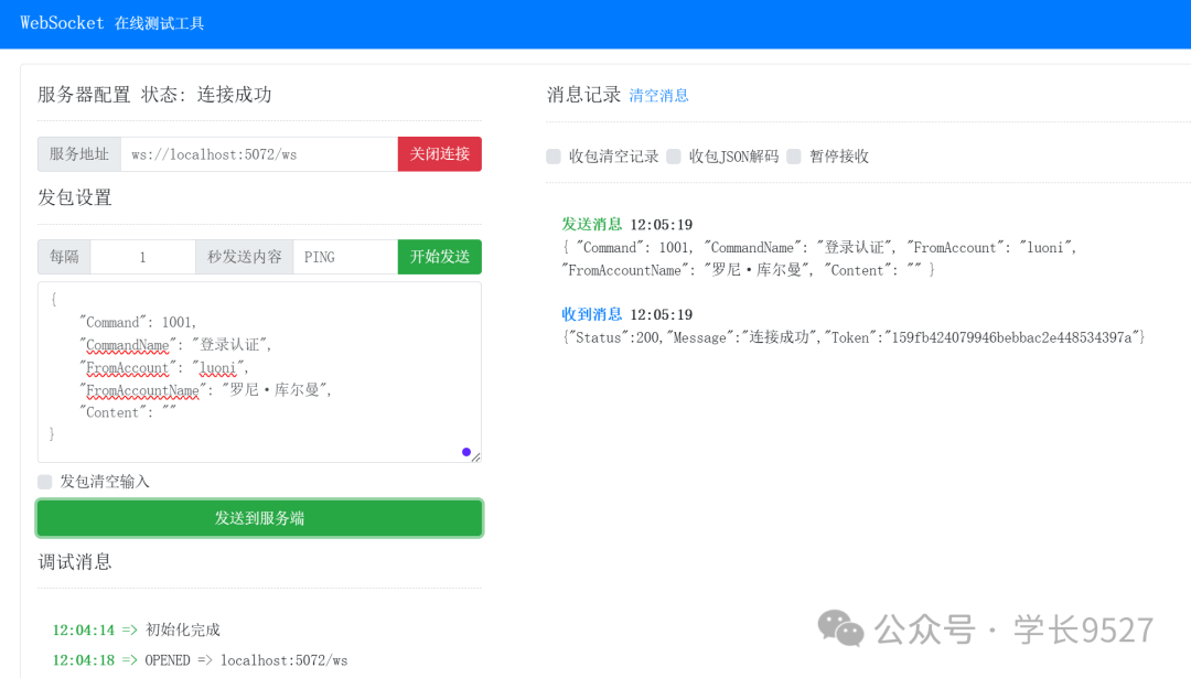

5、测试WebSocket
  5.1、用两台电脑分布打开https://wstool.js.org/
    输入ws://localhost:5072/ws测试地址,点击开启连接,提示连接成功后可以开始测试

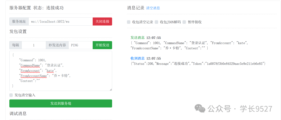

5.2、登录测试数据
# 根据执行命令来判定具体的操作步骤,比如Command=1001标识单个用户链接{    "Command": 1001,    "CommandName""登录认证",    "FromAccount""luoni",    "FromAccountName""罗尼·库尔曼",    "Content"""}{    "Command": 1001,    "CommandName""登录认证",    "FromAccount""qiao",    "FromAccountName""乔·卡特",    "Content":""}
5.2.1、分别在两台机器上发送登录认证消息,等待正确返回
  5.2.2、在另一个浏览器上执行另一个登录认证

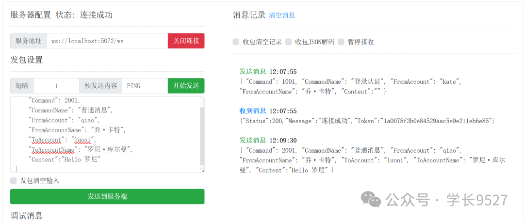

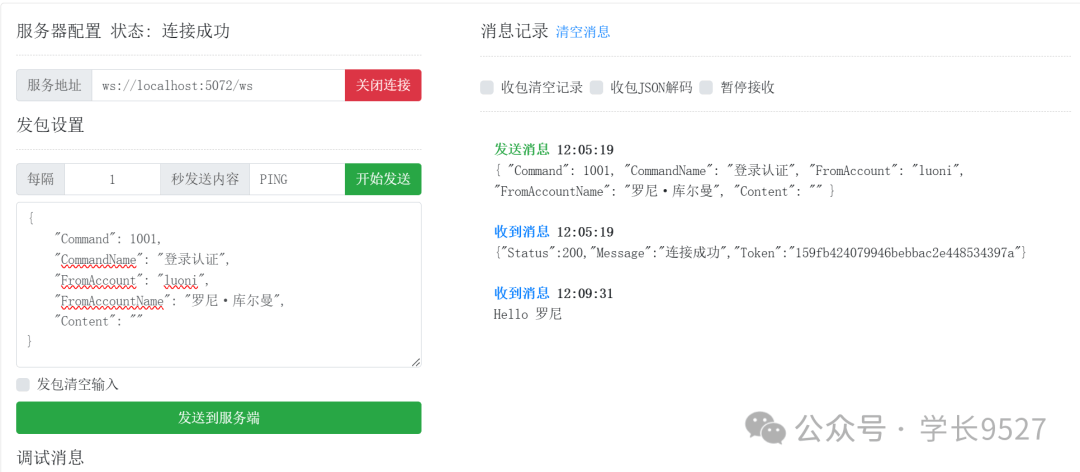

5.3、发送文本消息
# 根据执行命令来判定具体的操作步骤,比如Command=2001标识单个用户链接{    "Command": 2001,    "CommandName""普通消息",    "FromAccount""qiao",    "FromAccountName""乔·卡特",    "ToAccount""luoni",    "ToAccountName""罗尼·库尔曼",    "Content":"Hello 罗尼"}{    "Command": 2001,    "CommandName""普通消息",    "FromAccount""luoni",    "FromAccountName""罗尼·库尔曼",    "ToAccount""kate",    "ToAccountName""乔·卡特",    "Content":"Hello 乔"}
5.3.1、从乔·卡特这个登录账号中发出消息
5.3.2、在另一个浏览器中接收到消息,则表示WebSocket通信已完成

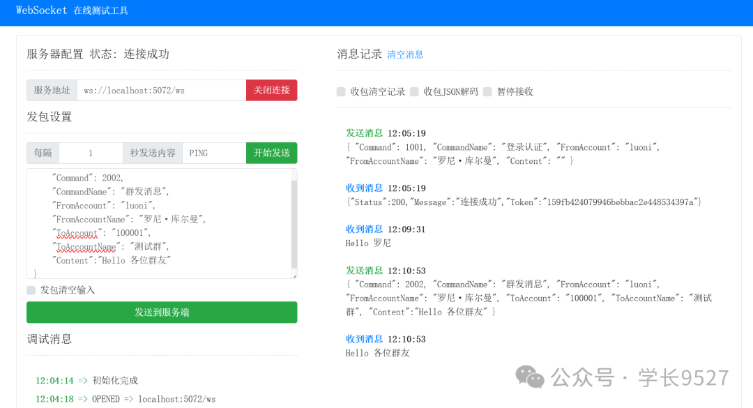

5.4、发送群消息测试
#群发消息、根据Command来识别{    "Command": 2002,    "CommandName""群发消息",    "FromAccount""luoni",    "FromAccountName""罗尼·库尔曼",    "ToAccount""100001",    "ToAccountName""测试群",    "Content":"Hello 各位群友"}
 5.4.1、发送群聊消息,所有链接在线的群成员都可以收到,并且自己也会收到一份,也可以不将发送者配置到群里,具体可根据业务修改逻辑
